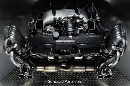

всего должен быть такой комплект
Kit consists of
Cylinder heads with flow-optimized intake and exhaust ports
Intake Manifold & Throttle Body - Increases inlet size from 76 mm to 82 mm
X51 Headers - larger cross-section and optimized flow behavior
Carbon Fiber Airbox with two intake channels
Modified maps for the DME control unit
Sport Exhaust with Chrome Tips & Dash Switch - (Optional)
Third Radiator Kit (for manual transmission cars)
Increased Engine Speed
