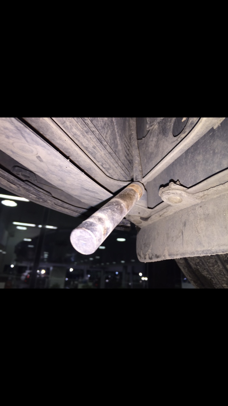

Hopefully the two pictures will work. One shows the new resistor in place and the other shows the front now I've fitted some mesh and DRL's.
